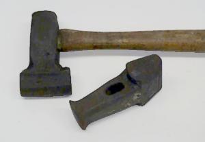

![](tutor/jdfuller/../../tutor/jdfuller/fuller1.jpg)
Figure 1 |
Fullers come in different types and styles. These are handled (upper) and shanked to fit the hardy hole (lower).
Earlier Bill Epps did one on the type that mounts on your anvil and has a pivot to support the upper of an upper/lower pair. Tonight we are looking at plain fullers.

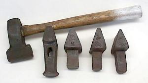

![](tutor/jdfuller/../../tutor/jdfuller/fuller2.jpg)
Figure 2 |
Handled fullers can be made straight and cross (the handle). The only difference is which way the handle hole is punched.

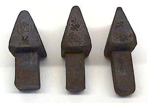

![](tutor/jdfuller/../../tutor/jdfuller/fuller3.jpg)
Figure 3 |
And then there is the old "wythe" or wihte style that originally were held with thin green branches (wythes) and latter by wrapped bar stock.
For more details see Rough, Loose and Withe Handles.

In smithing a fuller is a tool with a round or parabolic "nose" that is driven into the hot metal.
Photo above courtesy Kayne and Son.
Figure 1
Figure 2
Figure 3
