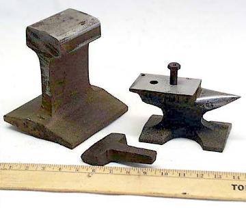

This little 6" anvil is made from some old pre 1865
steel. It has a spring steel top plate welded on. The bushing that fits the round hardy
hole is made from a 1/2" bolt. It has a through hole and impression to support a #6
Capewell nail for putting initials on the faces of the head.
The entire anvil's purpose was for making horse shoe nail rings.
In general RR rail makes a lousy anvil. We will get into that latter.

Heavy rail has about a 3/4" web and is great for the beginner making anvil tools to fit a small anvil (100 to 150 pounds).
This fuller was sawn off the end of a piece of 140# rail.
Note that rail is measured in the pounds per yard, not per foot like structural steel.
So a one foot piece of 140 pound rail weighs 46.7 pounds.
A one foot piece of more common 120 pound rail weighs 40 pounds and when cut to "anvil" shape maybe as little as 30 pounds.

After cutting two fullers off the opposite ends of a short piece of rail I had a handy bench anvil.
Notice the difference in the rail sizes. |

When making a small anvil like the first example, would the curve of the rail allow a groove to fill with weld to weld a top plate onto the top of the rail?
-guru |
Scout its alsmost impossible to weld all the way accros. This was a little light duty wire bending anvil.
SmithinScout |
OK, Yeah it would be a lot of welding hehe kind of impractical.
