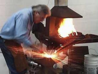

Tonights demo, is about forge welding. This is part one of two. The second part will be about forge welded joint design.
The photo above is Jerry Darnnel of North Carolina doing a forge weld using E-Z weld.
E-Z has powdered iron in it and makes the spray of fine sparks above.
Plain flux does not make such a fine spray.
