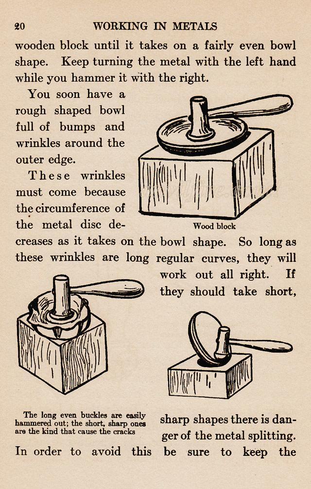

page 20, With the round headed hammer, using the rounded end, beat the metal disc into the hollow of the wooden block until it takes on a fairly even bowl shape.  Wrinkles, Wood block, dishing hammer.
Links:
WORK IN COPPER: How to Make a Copper Bowl. page 20, With the round headed hammer, using the rounded end, beat the metal disc into the hollow of the wooden block until it takes on a fairly even bowl shape. Wrinkles, Wood block, dishing hammer.
