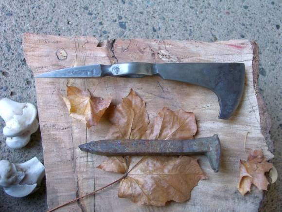

Tonight we are going to make a throwing hatchet from a railroad spike.

A Railroad spike starts out about 6" long and about 5/8" square. We are going to bump it up till it is about 1" square and 3 inches long.

After we get the hatchet shaped and the cutting edge filed, I harden the cutting edge (Only). I heat the whole piece until it is non magnetic and put the edge about 1/2" deep in to the quench tub. I never see any reason for hardening anything other than the working part. When it turns black and stops sizzling, I take it out and it let finish cooling on its own. This will draw the edge down to where I have a good tough edge, but still hard enough to stay sharp.

Back up a couple of steps, After I hot rasp and file the edge, I finish drifting the hole to size., then you harden the edge. After it is cool drive a store bought tomahawk handle into the hole. We buy our handles from Buckskinner supply houses or Centar

Spike Ax by Raymond Richard
Sample from Raymond Richard
Click for detail - Added November 7, 2002
