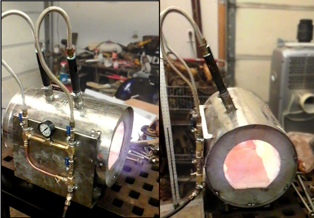

Pete Buchanon's forge built by Ted Banning using Black Beauty Burners.
Forge using Black Beauty Burners on Bladesmith's Forum
Single Burner Forge built by Dave Baker using one of our prototype burners.

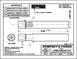

Assembly drawing of the Black Beauty P-75 with dimensions for installation.
Click for full size Adobe PDF.
How many times have you needed exact dimensions of something to apply it to a project?
It used to be that ALL manufacturers provided full dimensional information.
Today you often have to buy the item to find out if it will fit your project.

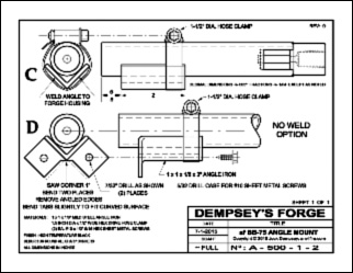

Tubeless Installation Options C & D for the Black Beauty P-75 Burners. Click for PDF.
The commonly used collar tube and set screws is not the only way to mount a burner on a forge.
Method D can be done with a hack saw and a hammer. No welding required.
Need a sturdier mounting in a thin wall forge? Double up on the "D" type brackets (one on the top and one on the bottom).
