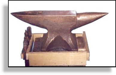

European Anvil (Larry, m.i. smithing): The photo you sent is of a forged European anvil. ![]() What is intresting about this anvil is the half eliptic horn. However, this is a fairly common European style. Postman has a cast English anvil of the same pattern from the 1930's that got here via the Far East on page 131 of Anvils in America. Maybe some of our European friends can tell us more about this pattern. ?? |

European Anvils: I asked Richard Postman about European anvils and he said there were too many makers to do the authorative type of book like Anvils in America. During the 18th and 19th century in America and much of the rest of the world outside Continental Europe, England provided a large portion of the anvils manufactured taking advantage of their trade advantages. This resulted in the English manufacturers being large, centralized and standardized. In Europe the manufacturers were smaller and made more regional styled anvils for local tastes. For many examples see the web page of Joël Becker at: couteaux.free.fr |

More: Larry, I'm guessing the anvil is forged from its appearance and lines that are common to forged anvils. However, the best way to tell is if it has handling holes at the waist under the horns. Cast anvils don't have handling holes, most forged anvils do. |
