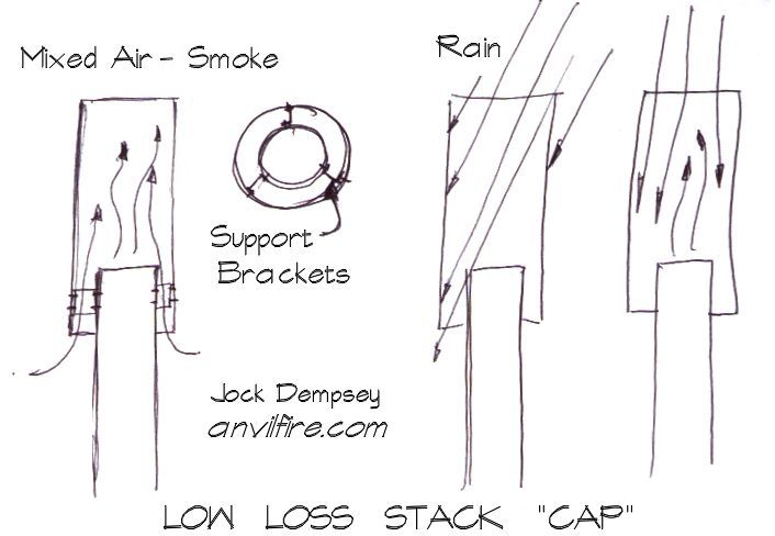

Hi, you guys have been a big help, I am getting my small shop set help. I am useing a side draft flue on my forge, I have a 12" chimney and am getting ready to put a rain cap on, but I was reading that the space between the rain cap must be at least the size of your chimney. So If I read this right I have a 12" chimney I should have 12"s between my pipe and rain cap. If this is ture what keeps the rain and the birds out of the chimney |

Jim, Read Tony & Alan's posts from a couple of days ago about a zero loss stack, I think it is in the archives now. It works much better than a cap from all accounts. As for birds, I would assume you need to put some kind of mesh over the top, probably a cone shape would be best. |

Stack Cap: Jim, you will have less problems with birds if you use the low loss stack cap we talked about. I gave dimensions for a 12 inch stack and see Alan's good description of operation. Most birds are not attracted to an open top pipe unless it is small enough in diameter for them to build a nest on. Birds like a hat section cap because it keeps the rain off their nest. The low loss cap keeps the rain out of your stack, but not off a birds nest. Don't put a screen on top of the low loss cap. No need for birds, and it will reduce the draw considerably. But if you have lots of sparks going up and out the stack, you may need a spark trap close to the forge. A smoke chamber should act as a reasonable spark trap for coal forges. If you want to use a higher loss, lower draw, hat section cap instead, you will want to have something around it to keep the birds out. |

Rain cap: Jim, The current consensus is not to use a cap but a low-loss stack shield (a larger diameter piece of pipe, see discussion above and in archive for May, 15-21, 2001) Personaly I like the cartoonish looks of a pointed cap. Diameter is needed for the distance problem (at least 2 to 2.5). It has also been recommended to put an internal diverter cap (an upside down cone) inside the top cone to create a smooth concentric flow at the cap. We have instructions for making cones on the 21st Century page. |

I don't seem to fine Tony and Allan's post about zero loss stacks. could someone tell me about it or tell where to find that post . I looked in the archives, but no luck. Thanks Jim |

Hi Tony and thanks, but I am lost, is there a pic. or a drawing of what you just told me? I have my 12" pipe 5'or 6' above the peak on my roof, now I take a 14" pipe 54"s longer and put on top of that????????? so now don't I just have a bigger hole at the top of my chimney only 54"s higher. Thanks Jim |

Low loss stack top: Jim, You've got it mostly right. I’ll try to clarify. I don’t have a picture to post. If your stack through the roof is 12 inch, you will want a 54" long section of 14" diameter duct. Your 12 inch stack can be cut so that it is at least 3 feet above the roof or more. Make 4 spacers that are six inches long and 1" by 1". 1" by 1" by 14 gage steel tubing would be ideal for the spacers. Slide the 54" long section of 14" pipe down over the 12 inch stack coming through the roof. The overlap should be six inches, so you will be adding 4 feet to the height of the 12 inch stack. Slip the 4 six inch long spacers in between the 12 inch and 14 inch pipes at the overlap, space them equally at North, South, East and West and screw the two pipes together through the spacers. Support the stack and cap as required. Yes, you will now have a 14" hole that the exhaust comes out of. And it will be 48 inches higher than where your 12 inch stack ended. 54 inches minus the 6 inch overlap. Make more sense? Don’t think of it as a cap. Think of it as a stack extension. The total height of your stack above ground should not be more than twice the height of your building. So if your building is 12 feet from the ground to the peak, your stack should not be more than 24 feet from the ground. With the low loss cap, the gap between the two pipe diameters should be at least 3 feet above the roof, so with a 12 foot building height, and a 12 inch main stack, the top of the stack would be at least 12+3+4=19 feet above the ground. Let me know if it is not clear. Yeah, a picture would be worth a thousand words. I could fax a sketch if the guru wanted to post it. Or you could buy the book it came out of for $90. Grin. Hope this helps. |

![]() Click to enlarge
It primitive but I think it gets th point across. Send that $90 to . . . . |

Tony and Guru, thanks for all the help. I think the drawing done it, the light came on and I think I under stand.This is a great page for new people to come to and find out what they need to know. I thank you all for being so understanding. I have alot of pine trees all around my shop, do you think that will be a problem with no screen? if I were to put a large screen at the top of the 14" pipe, do you think that I would have a draft problem? Thanks again Jim |

Screen: Jim, Probably not but it DOES reduce the efficiency AND make a nesting place for birds and leaves. Spark arrestors are put on the sides of stack caps. Using coal the screen must be stainless steel or it won't last long. I couldn't say without seeing your shop situation but coal forges put out almost no sparks that leave the chimney. Charcoal is not as good and paper for starting the forge is the most likely source of any sparks that leave the stack. Locally (Virginia) pine trees are not much of a fire hazzard unless they are dead but in more arid states there may be a different situation. Pine needles in gutters could possibly be a problem. |

Jim Glines: Also, if you put a screen atop the stack you lose the rainguard function. Any water that hits or condenses on the screen will fall straight down your chimney. My stack exhausts straight up into a maple tree (or an ash, depending on wind direction) with about eight feet of clearance. No probs so far. |

Screen on stack: Codes, laws, rules.... man, they are everywhere. Sometimes good, sometimes bad, sometimes uninformed and down right wrong. But sometimes they are easier to follow than buck. You decide. Pete, the screen on the inner stack is an interesting idea. For a straight up stack with no elbows, 12 inches in diameter, I'm inclined to say a screen on the top of the inner stack won't stop the draw. It will be a restriction, but it will probably not be enough to cause a serious problem. But I can guarantee that if the stack is used only occasionally, at some point, a bird WILL build a nest on top of the screen on the inner stack. At least it would surely happen in Wisconsin. My gradfather died because of a stack cap with screen. From the smoke backup in his home caused by a bird nest in a stack cap. All was fine when the fire was roaring, but he went to bed and the fire got colder and the draw was reduced and smoke filled the house. He ended up with severe brain damage and died of esophogeal cancer a year or so later. Yes, he should have gotten up on a ladder and checked it before building that first fire of the season. My father installed the stack cap and feels guilty about it to this day. Obviously, that is not likely to happen in a forge situation. Here are the facts. Believe them or not. 1. A 1/4 inch screen on top of a stack will not stop all fire causing embers. Install one if you must, but don't rely on it to stop all potential fires. 2. As I have said before, a much more effective way to reduce the embers and sparks is a screen in the smoke chamber. The gas velocity in the smoke chamber, behind the opening to the forge, is lower since the area is larger. And the gas is more turbulent there since it is changing direction, so it is more likely that any sparks will hit the screen. The problem here is that building officials are uninformed and treat a forge as a fireplace. And even the fireplace rules are uninformed and dangerous. If my explanation about the screen in the smoke chamber is unclear, please ask and I will try to explain better. |

Good Tony: I proposed a conical inner-pipe screen thinking that the steepness would discourage birds and allow for more surface area to clog up. |

Conical inner cone: Pete, I was going to suggest the same thing. Then figured it would make a nice nesting place OR a hidden place for leaves. Spark arrestors need a large, visible, vertical surface. Vertical to prevent debris from collecting, visible so it can be inspected from the ground, and large to prevent flow reduction. I like Tony's idea of putting the screen on the intake next to forge where you can easily clean and inspect it. |
