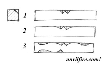

![]() Whitesmith chamfering. This may not be the absolutely correct term but it IS technicaly correct. Tools to do this project (2 files and a pair of vise-grips) should cost about $35. The files need to be good sharp (new) smooth cut files. The key stock should only be a dollar or so. |

Filing: Files cut on the forward stroke. Push firmly and use as long a stroke as is comfortable. Then lift the file off the work on the return. Set the file back in place and push firmly again. After every couple strokes clean the dross (filings) from the file by sliding your hand from grip to end (backwards of filing) to remove the chips from the file. If you do this every 2 or 3 strokes the file will stay sharp and cut much longer. Long smooth purposful strokes are much more productive than short draging strokes. |
