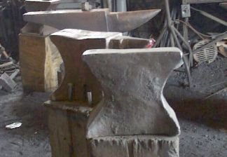

Broken Anvils: Thomas is quite right. It is fairly common to come across anvils with missing horns or heals broken at the hardy hole. The most used part is still hardened steel with a LOT of mass under it. I have an old colonial with a missing horn that I gave $5 for.
See the photo I posted on the Hammer-In. That hornless anvil in the background is in good shape otherwise. To supplement the lack of a horn Josh ground a heavy radius on the edge where the horn previously was. For most purposes a round edge is as good as a horn. I suspect that most folks would miss a hardy hole more than the horn.
Josh used this anvil and one made from a cylindrical A36 "drop" at last year's Spring Fling to prove a point. You don't need a "traditional" shaped anvils to do good work.
The fact is that from an historical perspective it is only quite recently that anvils had horns. There are large numbers of colonial era anvils that were made without horns. These were suplemented by stake anvils OR in cases where much decorative work was being done the stake anvil was the only anvil.
Thomas is also right about vises. If I had to give up my anvils or my vises I'd say take the anvils. . . I guess I have a vice about vises.
   - guru - Monday, 12/10/01 17:52:11 GMT

Anvil update: I stopped at the tech school to look at the anvil a friend is cutting out of a 200 pound block of (probably) mild steel. I had to buy her a special tip for the big scarey cutter the school has but so far this project is well under 40 bucks. She's going to knock off for the holidays which gives me time to post questions. Her instructor recommends a hardened steel plate be welded to the face. Previous posts about this have resulted in not very encouraging responses. If I decide to have this done is there anything I can tell this gal that would make the task easier and result in a better anvil?
Thanks!
   - Khym - Thursday, 12/13/01 07:41:29 GMT

Khym: if you weld the steel plate with a heavy "V" (something like this > )on the mild steel part.
And then preheat the (about 1.5-2" thick and 1/2" wider than anvil face) body to leave room for triming)face it should work then mill flat and heatreat (aneal harden and temper) then polish. if you put a layer of stainless on the face and heattreat you may get away with a marginal pre/post heat (I did but it may have been luck)
   OErjan - Thursday, 12/13/01 15:02:22 GMT

Fab Anvil Khym, First I recommend that not too much be cut off that slab to make it an anvil. The current weight is good but converting it to a classic American pattern may reduce it by half (unless the pieces cut off are welded back on). Look at how efficiently these two antique anvils use material (the anvil in the background is a 350# Hay-Budden). These small anvils are VERY solid for their 125-150 pound mass. Shops with the hornless variety often had stake anvils which are almost all horn for doing bending and scroll work.
Antique group of anvils (c) Jock Dempsey
Two antique anvils, Greenwood Collection
The face on old anvils is forge welded on producing a continous weld. Edge welding a plate onto an anvil results in a "dead" anvil due to the space (all unwelded joints are a space) between the face plate and the body. Heavy V'ing helps but still leaves a dead spot. Then there is always the problem of heat treating. The plate (if tool steel) needs to start anealed, be preheated before welding and then heat treated later. A good piece of tool steel the right size can be a considerable expense. A piece of large leaf spring will work if the anvil has a narrow face. It can all be done but is a lot of work for what you get.
You can also "hard face" the top with welding rod. Current recomendations are to build up with an E70 series rod like E7024 and then a cover of an E100 series rod such as E10024. Although some use "hard facing" rods it is not recommended as they produce too hard and brittle a surface. This also is a lot of work and expense (energy costs on top of the rods). AND there is a LOT of grinding to clean up the surface.
That is why I now recommend starting with a piece of medium carbon steel such as 4150 or 1050. Add on a horn of mild steel if needed. Flame harden the face.
On the other hand, this is your friends project and she will probably do what works best for her with whatever is available. That is the fun part of this type of project. Making something out of almost nothing.
Everyone wants a "modern" looking anvil with its exaggerated shape. . .
   - guru - Thursday, 12/13/01 17:53:03 GMT

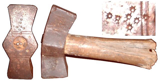

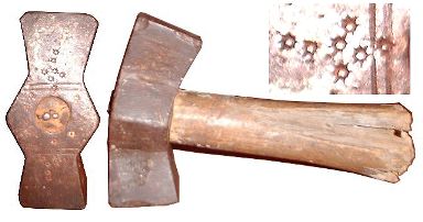

I'm looking for a hammer expert. I believe this is the place. I recently aquired a very strange hammer. Perhaps someone here can help me identify it. Looking down from the top it looks somewhat like a bowtie. From the side it is arched dropping about a quarter of an inch at each end. Face to face the head is about four and a half inches long. The faces are one and five eights square, very slightly crowned almost flat and show signs of being applied. The handle is six inches long and one and a half in diameter, although badly spilt was knife made and seems original. It is decorated on all four sides with an asterisk shaped punch. I do have digital pictures if someone would please have a look.
   Chris Turley - Saturday, 12/15/01 02:34:23 GMT

Odd Hammer Chris, Sounds like some type of raising hammer.
Try koka metalsmiths Bill's online catalog has a large selection of that type hammer. Also check the Kayne and Son hammer page. If its not on either then e-mail me the photos.

Chris Turley - The hammer you just described sounds to me like a miner's "single jack" hammer. The short handle, arched top head and large faces suggest that to me. The top of the hammer was curved at approximately the radius of a man's forearm plus the length of the hammer to allow swinging it right next to the top of a stope (horizontal shaft) in a mine, star-drilling hard rock.
On a side note, the term "balling the jack" comes from the same action...the jack, or drill, would become balled or mushroomed, after much hard pounding. One jobof old mine company smiths was to refurbish those drills by re-pointing and cleaning up the "balled" heads.

Chris,
Sorry, I missed your question, and Rich thank you for catching it.
I think Rich has answered you, Chris. But if you'll send the pic to me, I'll double check. As it happens, I've spent time on a single and a double jack both. (wry grin)
No, I wasn't making little ones out of big ones, I was working in a hard rock tunnel for my father-in-law to be.

Chris's Odd Hammer: Here it is. Click for larger image.
Odd Hammer, click for detail

Chris,
Old fashioned, hand made, single jack.
Rich nailed it! (sorry, grin)
Looks like the asterisks form a crude Big Dipper and North Star, long the symbol of Alaska.
